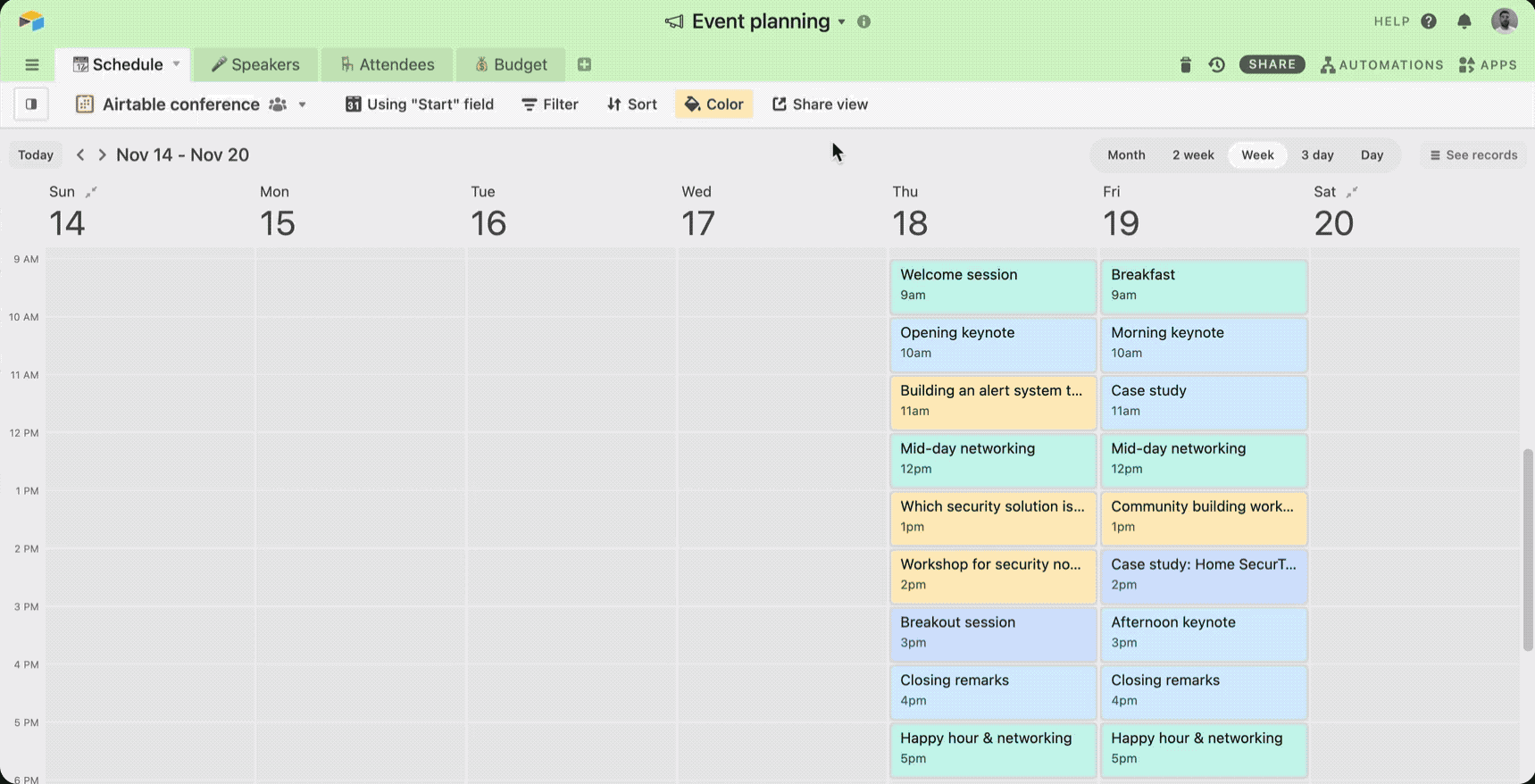

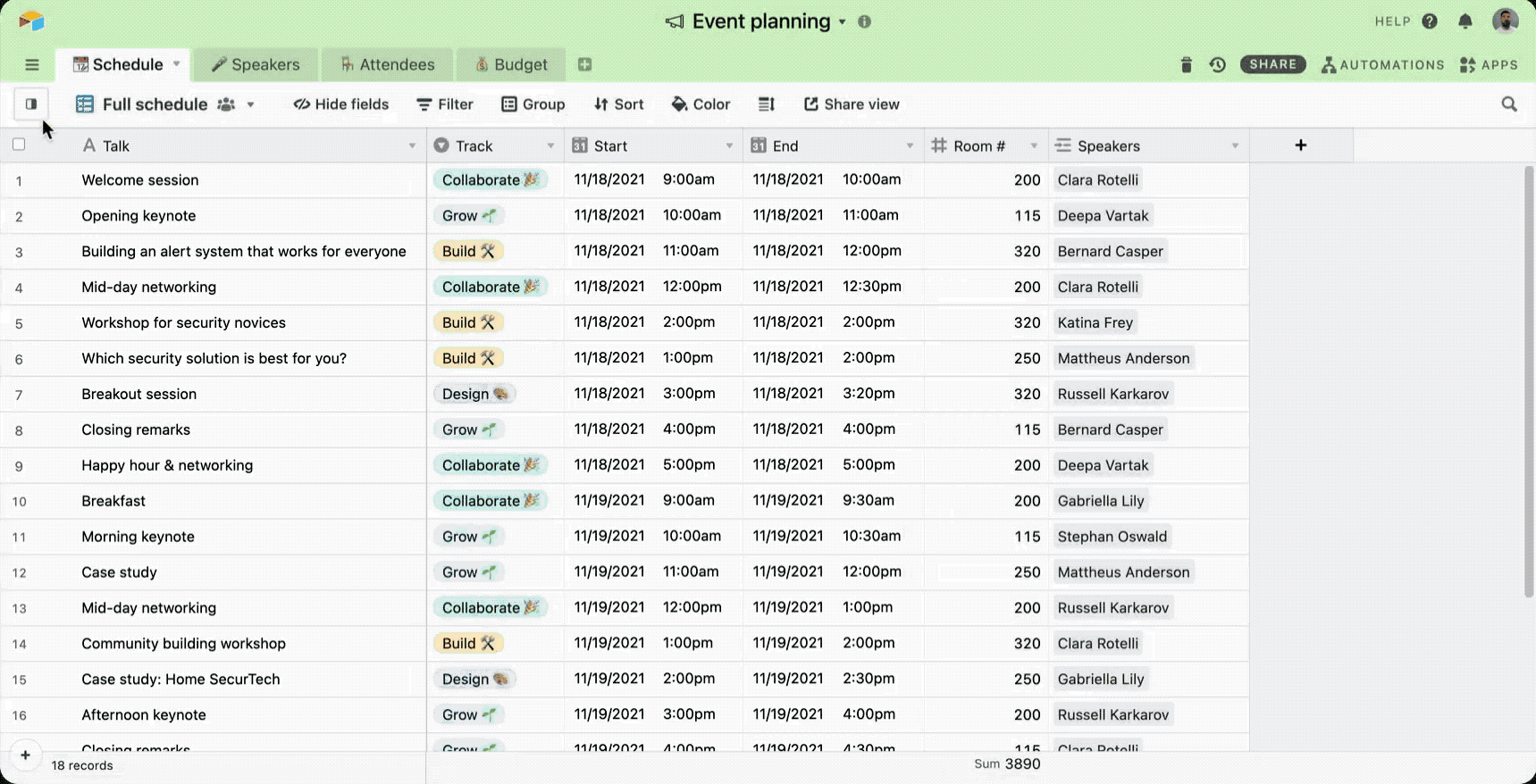

The first step is to create a calendar view within Airtable to see your series of records as events. These records need to have a start time, an end time, and a title in order to populate the calendar correctly.
Here’s an example. Let’s say you’re managing an event using Airtable, and set up every record in the “Schedule” table to represent a talk—with a title, start, and end time—and then make a calendar view, showing those talks chronologically.
To share your calendar, go to the “Share View” menu and click “Create a shareable calendar view link.” This will generate a link to your calendar view within Airtable that you can share with anyone, but to sync with an outside service, you want to go down to “Sync to an external calendar” instead. This generates a URL that most calendar applications can use—such as Google Calendar, Microsoft Outlook, or Apple Calendar.
Now your calendar will automatically populate with every talk in your event, and if you update the talk, your calendar will update too.

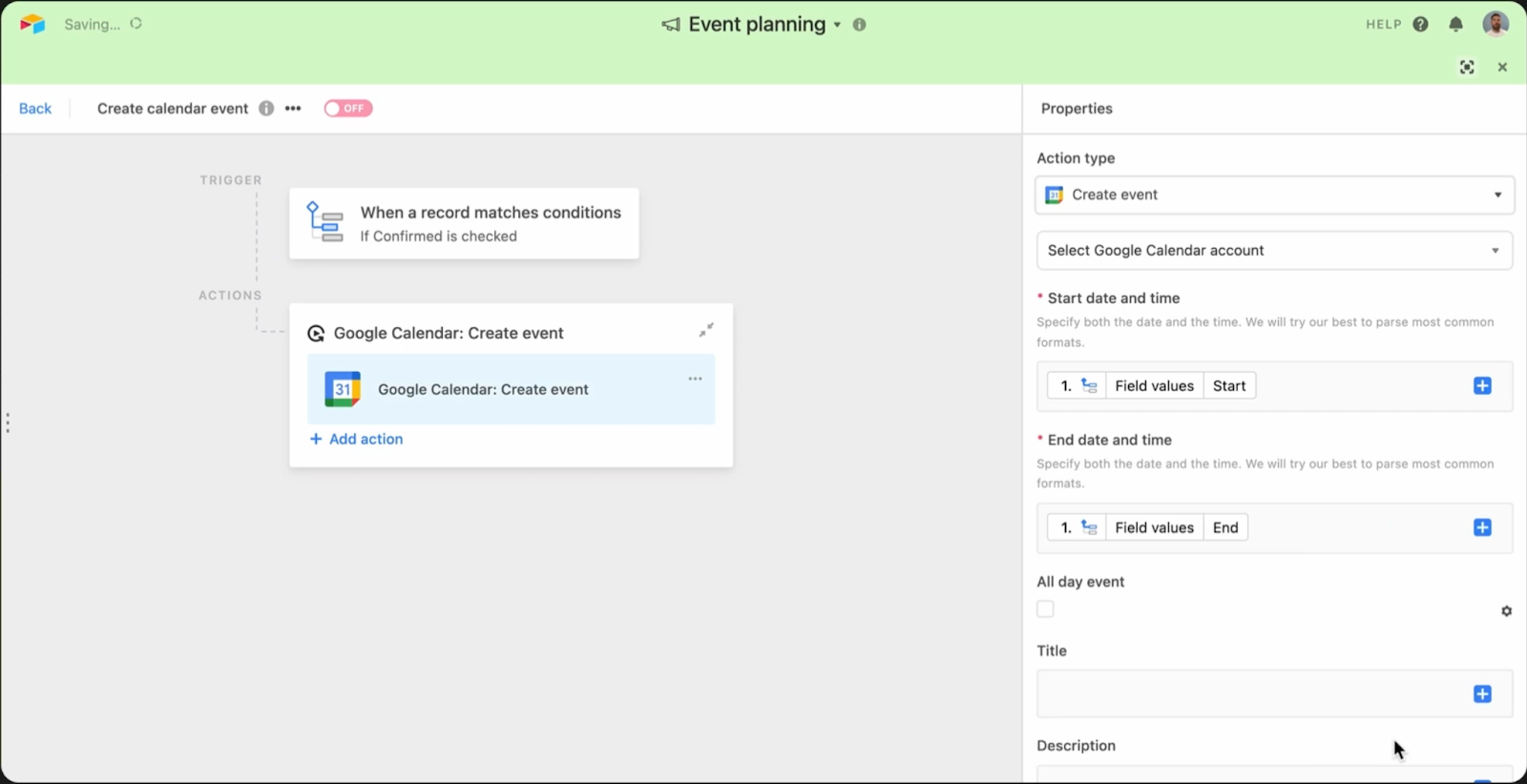

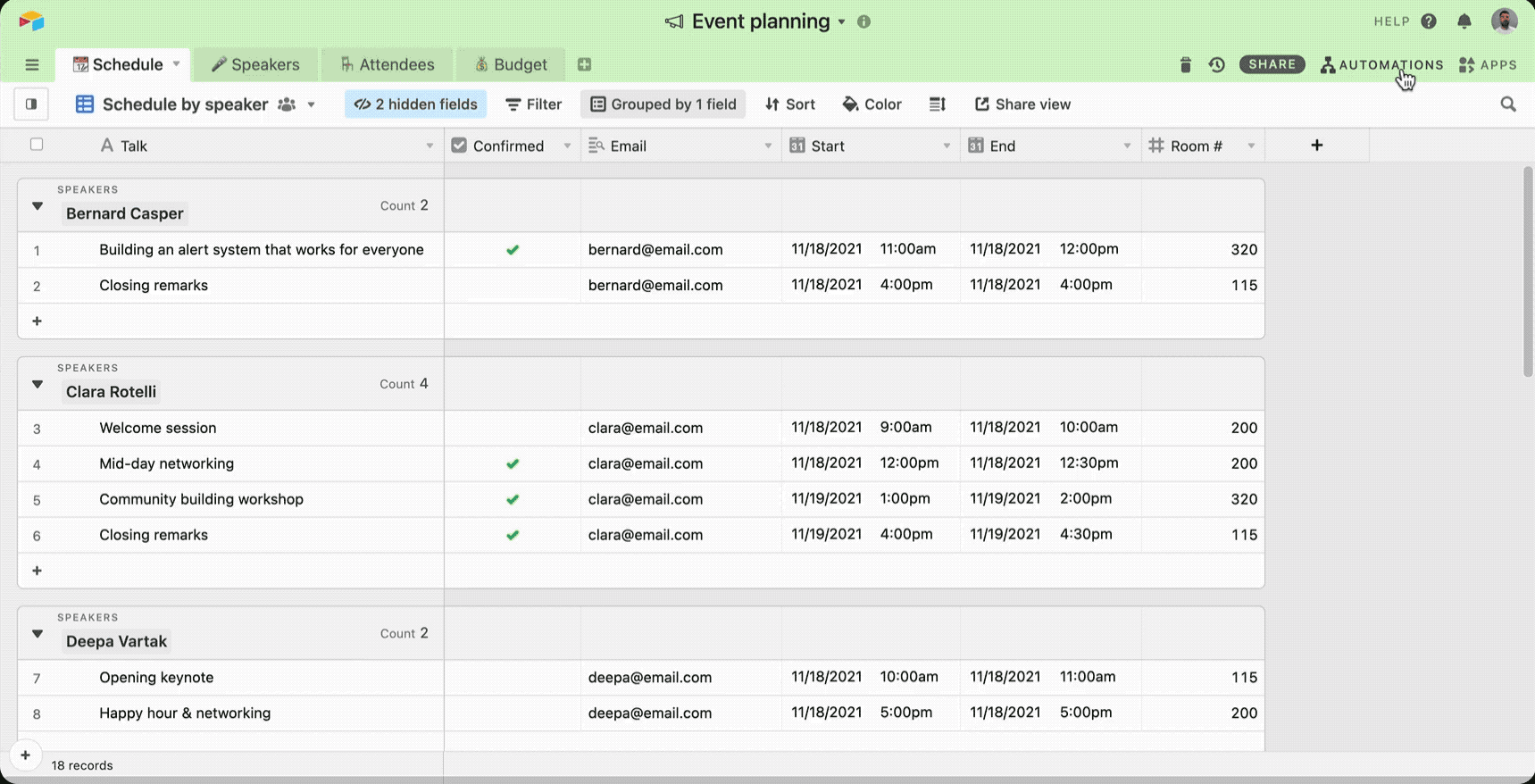

With Airtable’s automations, you can create even more powerful and customized synchronizations. For example, you might not want to sync your whole calendar, but would like to use certain events to trigger an outside calendar—like sending speakers dedicated invites for their speaking slots.
For this, go into the Automations menu at the top right of your base and select “create a custom automation.” To send out an invite whenever an entry gets confirmed, we set up a trigger as:
  • Trigger type: When record matches condition
  • Table: Schedule
  • Condition: when the “Confirmed” tag is checked
Once you’ve set your trigger, run the action “create an invite.”
From there, grab the start time, end time, and location from the record, and invite the speaker using a record’s email address. Now whenever a talk is confirmed, the speaker automatically receives a calendar invite—without being flooded with every single talk for the entire conference.
